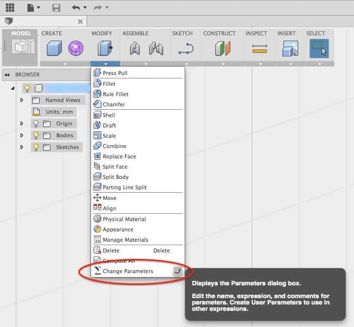

I would like to see a feature where you can add global dimensions, equations and variables for your model so that you for example can assign them to your sketch dimensions. When you change the global dimensions, equations or variables it wil be updated througout the model etc. to make easier and faster changes to your model.

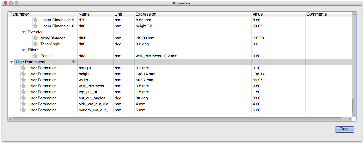

Driven Dimensions are not captured in the Parameters window.

I don't think this is a solved issue. One of the problems with parameters is that they exist in the same history / undo timeline as all of the other operations. So if you go back in the timeline to a point before the parameter was added, it won't be there to use. If there is a reason that it must be this way (and I can conjecture a few) then perhaps you could simply add a flag in the parameter modify window to indicate whether you're adding "Global" parameters which exist outside of the timeline, versus parameters which are bounded by the timeline.
I have had this particular problem on a number of projects where the idea of various parameters tend to emerge organically from the project being designed.

HughesTooling
If you roll the timeline back all parameter created are available but if you click undo after creating a parameter it is removed. Don't see the undo behaviour as wrong though as you might change a parameter and want it changed back.
Here you can see parameters created after where the timeline pointer is positioned.

Phil.E
Global parameters are available via Derive.
Workflow
  1. Create an empty design
  2. Add global parameters to the parameters table
  3. Make them all Favorites
  4. Save it as Global Parameters
Start a new design
  • Use Insert > Derive
  • Pick "parameters" option
  • Select the Global Parameters design
The global parameters will appear in your design.
