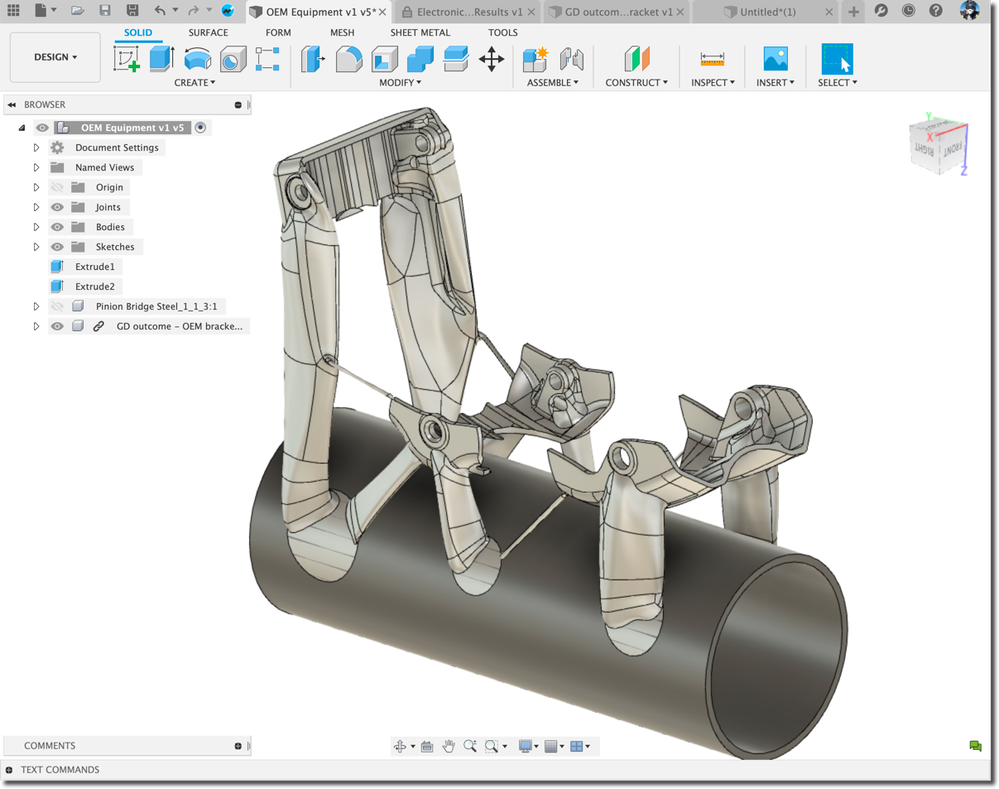

I admit, it wasn't that straightforward for me but I do have something interesting to share  With the loading in a single direction, there were a total of 42 iterations generated to satisfy the defined conditions. I chose the shape of iteration 30 since it seemed the most appealing, even though Min factor of Safety was above 20.
As you add more load cases, with different loading conditions, the generated shape will have different load paths to consider which could dramatically change the shape accordingly.
What added to my coming up to speed on this design is that we're taking a hybrid approach to GD, since the cradle body is already defined with bult-in gussets and fillets for added stiffness. This is why I had to hack away, because I felt like the existing geometry was being too restrictive for the solver.
If I were to try this again, I'd approach it similar to how the ALCOA bracket sample is set up. We include just enough geometry for the bolted connection points (the material around the countersunk holes) for the preserves. This way, it will allow more freedom for the solver.
However, we need to create and use obstacle bodies that are necessary to block material from being generated that would interfere with the space needed for fastener insertion, tool clearance, and any maintenance considerations ( e.g. I suspect that's a drain plug access hole), etc. It's the same as required for the conventional design approach, which we need to have defined for the solver to consider as well.
Hope this helps! As always, please follow up with any further questions and final result image, if possible 🙂

Thank you I was too eager and downloaded it anyway!
It looks great and its great to know what tricks there are regarding fill in where the bolted areas would be.
My final question is how do i then modify it further, id like to beef up those smaller struts if possible!

The shape can be modified in the Tsplines workspace. There are special tools made just for editing GD outcome geometry, with videos recorded when we first introduced the functionality. For example, there is a tool that can automatically re-orient a member to a different position, straighten it, etc.
The design from outcome is created through a parametric recipe, which is what you see in the timeline history. It consists of the preserves, obstacles, and the generated outcome shape. The outcome shape is created from a voxel mesh (akin to a stack of up to millions of sugar cubes) used by the solver, which is then converted to a tspline body. Through a series of joining and subtracting operations, the bodies are combined to achieve the final design.
There are rare occasions when conditions get tricky, and for some reason or another the parametric recipe chain breaks somewhere along the way. In that case, it may be possible to tweak the Tspline body shape as you suggest, which could allow the model to snap together.
Best of luck Sean! 😃 I'll see if I can find a link to the Tspline modification video.

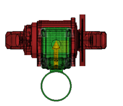

I'm trying again on my on with bolts and the gearbox in place and with my own calculation of torque and getting blobs again! I'm not sure where I keep going wrong! everything seems to be correct, but obviously its not

This is what I ve done so far.
Constraint the end of the cyclinder, moment on each hole, preserved the mount and cyclinder and made the gearbox and the bolts obstacles..Screenshot 2020-08-07 at 18.13.36.png
