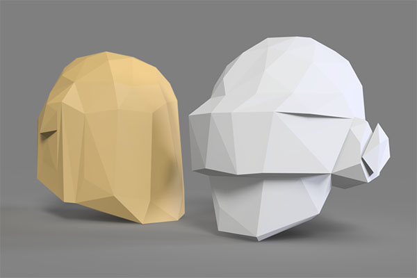

I want to create a model in a distinct low polygon look. See for example:
https://www.pinterest.com/pin/505247651920270126/
Any advice on how to get that type of look in Fusion? Since the shape is very simple (a heart), it would be sufficient to find a way to reduce the number of faces of a model. I guess I'd have to use the sculpt workspace for this, correct?
Thanks!
Michael
