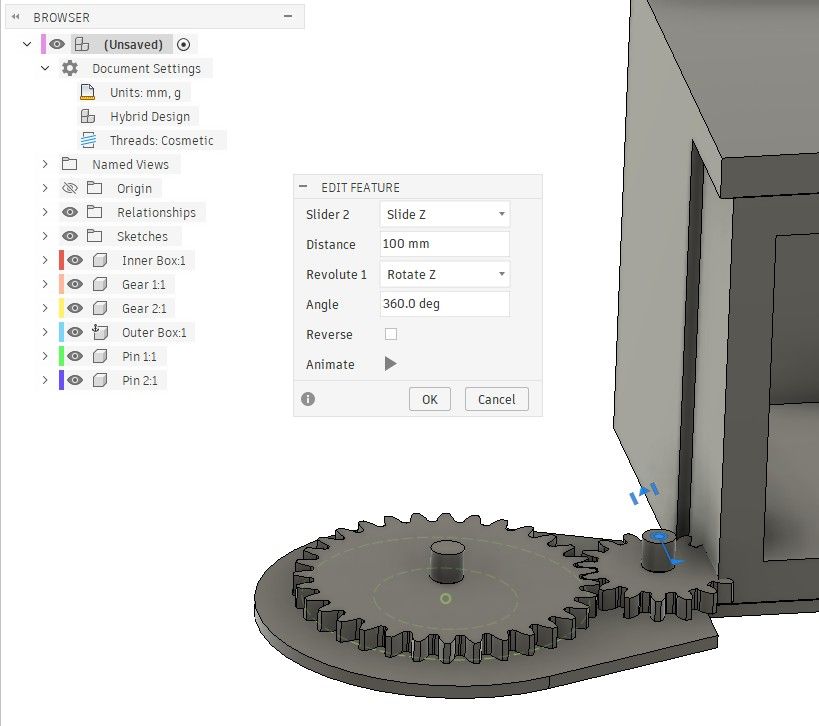

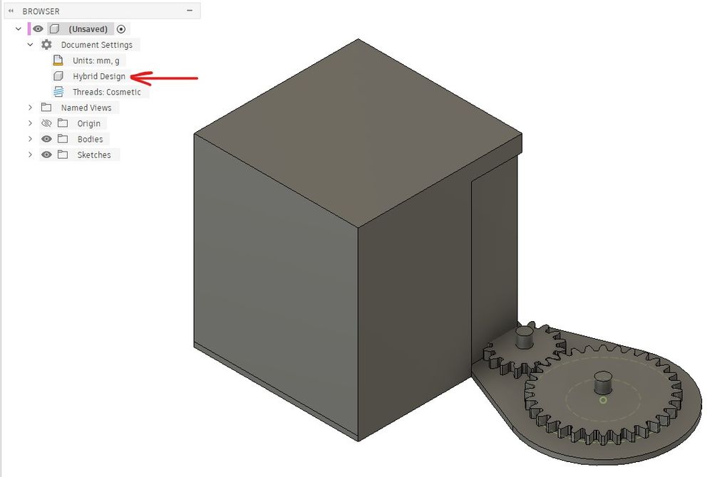

Hi, I'm trying to design just a simple prototype for a larger design so I can understand the concept of gears before I implement it, but when figuring out how to convert the rotary effect of a gear to a sliding effect, in order to push something like a box forward, I got confused. Can anyone help me? the screenshots below and file should explain the issue at first glance.
I basically want to get the 2:1 gear ratio to spin and push the box forward, but I get confused with how I'm meant to make the turning force into a sliding motion, I think I'm meant to add a line of teeth into the side of the box, but even then I'm confused.

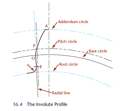

What you are naming Base Circle is actually Root Circle (and should be dimensioned).
Reference: Giesecke et al
More information to follow later...

scottprater
Hey Timeless, no teeth required.
Step 1) You need to convert your design into a Hybrid design. You can't define joints/motion between the bodies of a single component.
Step 2) Create some new internal components for each of your bodies (after you make the internal components, you can just drag and drop the bodies into them).
Step 3) Define your joints (revolute for gear, slider for box), then use the Motion Link tool to define the relationship between the two.
-Scott

Drewpan
I am a little confused as to what you are trying to achieve and how you are
modeling it. There are a few ways to translate rotational motion to linear
motion. Probably the most common way would be with a Rack and Pinion
system.
There is a couple of ways to make it happen. Either the Rack is fixed and the
gear rotates along the rack and the linear motion translates to the movement
of the axle. The other way is that the axle is fixed and as the gear rotates the
rack is moved linearly.
In the image you have provided, what is missing is the rack for the gear to move
the box in and out.
In terms of how to get fusion to do this then as mentioned by @scottprater what
you need to do is set up a motion link between the gear and the box. As the gear
Revolute Joint rotates X degrees the Slider Joint on the box moves Y distance.
This principle is almost identical to setting up a screw with a threaded rod and
nut.
Cheers
Andrew

TimelesslyTiredYouth
Thank you all for your replies.
@Drewpan now that I've seen what you've written, I believe the right way for me to prase my issue is, "I'm trying to design a rack and pinion system, where the axle is locked in place and the rack is being moved back and forth; my issue lies with the fact that I don't know how to make perfectly shaped cone things on the rack for the gear to spin on"
@TheCADWhisperer I used the spur gear add-in. I'm still learning how gears work and how to design them, in this case, I'm just looking at the concept of a "rack and pinion system" as I wanted to finish a project I wanted to use this for quickly, but if you have any advice on designing gears and rules, and tolerances I should follow, I'll happily hear them as I'm in the process of trying to understand how to design gears, understanding tolerances, ratio's and torque.
@scottprater, your such a lifesaver😂, I recently came back to fusion and I saw the part design, hybrid, so on so forth after updating fusion and i was so lost, I chose part design hoping for the best and I was severly confused when I couldn't make joints or components, seeing only joint motion when i used the pop up search bar.
SO my rephrased question really should be :
"I'm trying to design a rack and pinion system, where the axle is locked in place and the rack is being moved back and forth; my issue lies with the fact that I don't know how to make perfectly shaped cone things on the rack for the gear to spin on" - what's the correct design process for this? and to know the correct dimensions for designing the inner cuts, do I have to know the exact dimensions of the gear it's linking to, preventing me from using the spur gear ad in?
Kind regards

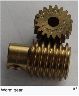

So I am still a bit confused about these "cone things" you are referring to. Also I said
that a Rack and Pinion is ONE method you could use. A Worm Gear system would also
work. In terms of learning about gears a very good place to start is Wikipedia (where
90% of what you read MIGHT be true, but in this case it is quite comprehensive and
a good place to start). https://en.wikipedia.org/wiki/Gear

Message 8 of 18
Thank's for the reply @Drewpan , these topics I'm exploring right now aren't entirely related and I have already planned for this project, i.e., PETG, one of lubrication, mass load limit of 50g, fast moving (thats why the 2:1 ratio), these were just a few topics I mentioned for context with me trying to learn about gears in general.
Anyway, I've mainly solved my issue using your first post (I started again with a hybrid design)
and all I have left to do is work out how to add joints, as it seems to have changed since the "parts, hybrid designs, assembly, ect..." update, or I could just be thick.
I've attached the file below if you think my workflow, or anything I've done is wrong that needs to be brought to my attention,
Kind regards
Ricky
Message 9 of 18
scottprater
Hey Timeless,
You're doing good so far! Joints haven't changed at all actually since the update, so you shouldn't have any problems making your motion link. Just be sure to "Unground from Parent" any parts you want to move (like your SPINNY GEAR!; I would ground your SPiiny tiing! instead). Because your parts are already positioned correctly, you can use "As Built" joints just to define the motion they should have (slider and revolute for the box and gears, respectively; make sure all of the parts are joined with your SPiiny tiing! base plate).
-Scott

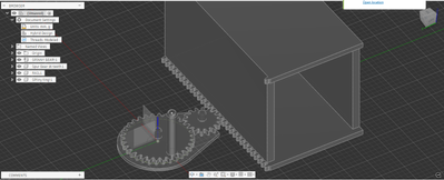

It's a bit rushed but I'm presuming this is what u meant by a box to hold it:
Message 13 of 18

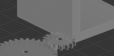

TheCADWhisperer
@TimelesslyTiredYouth wrote:
It's a bit rushed ...
Message 14 of 18
TheCADWhisperer
Message 15 of 18
OK, yes I saw the overlapping bit I've fixed it. Thank you for help with the maths ! so it's diametrical pitch circle mulitpled by PI for distance when converting from rotary to linear motion?

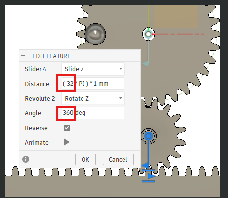

One other thing to mention: In this configuration, the 2:1 ratio between the two gears will have no effect on the amount your box moves. It will only affect its direction. To achieve a 2:1 ratio you will need to use a compound gear. I seem to be unable to paste images into my replies otherwise I would've inserted one to show you what I mean.
EDIT: managed to add the screenshot:
