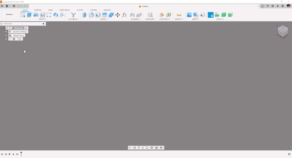

Message 17 of 63
jhackney1972
The Animated GIF will show you how.
