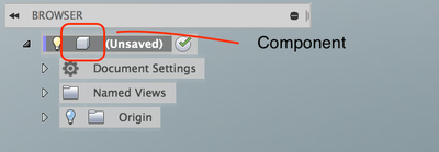

TrippyLighting
Each design in a Fusion 360 project is already a component. Here's a screenshot of a fresh, yet unnamed component:
So in case you only want to design one discrete part like, for example a single gear for 3D printing you don't need to create another component within that design.

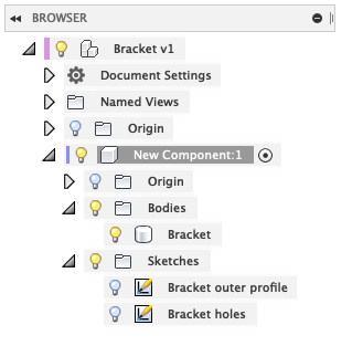

If you want to create more than one discrete part, because you want to design an entire gearbox in one design (file) with all the gears, gaskets and fasteners, then maybe you should start creating a component.
In that case the top level symbol in your design file will change to that of a component group otherwise also called assembly:
As such in most cases it would not make much sense to automatically create a new component in a new design file as it would really create an assembly with one component in it.
The other reason that it is not advisable is described to create a new component automatically in one of the exceptions of R.U.L.E #1 and that is if you create more than one body from a single sketch and then turn each body into it's own component. Thats a valid and sometimes very efficient workflow and creating a new component automatically would not work.
