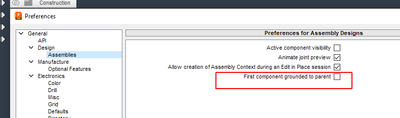

3 - "Ground" is not longer possible.  When I attempted to ground a joint, >Right-Click< shows "Unground" (I had not grounded the joint before as it hadn't even been defined before this).  Ungrounding breaks the design - at least, I can not re-ground the joint (not sure why Grounding is necessary, but when I learned about designing dovetail joints, the tutorial indicated this as a step) - "ground" appears as grayed out (unselectable) 😞

I think item 3 is because of a new feature, New Ground to Parent (GTP). See What's new. You can disable this to get the old workflow, Ground has become Pin.
You can disable in preferences.
