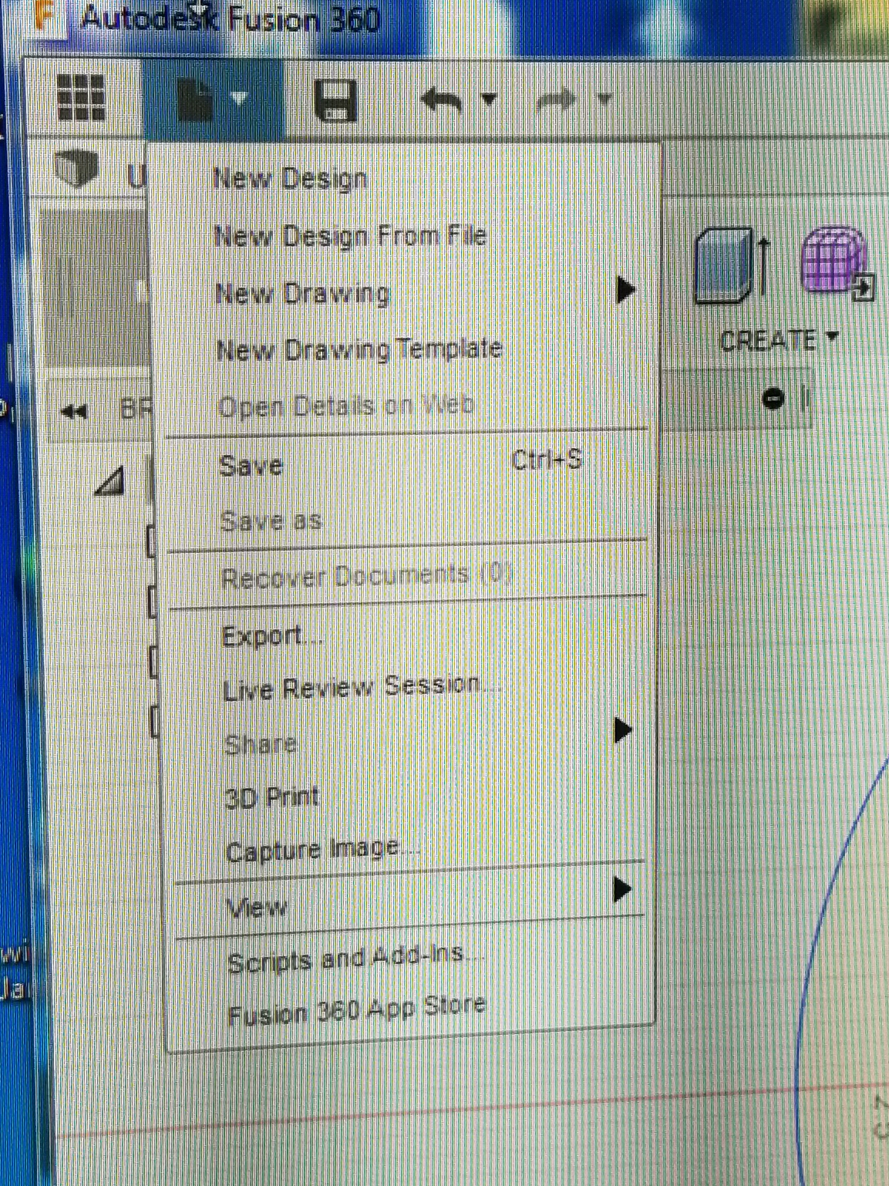

I am a hobbist, and would like to learn and use Fusion 360.  I have seen online help, where there is a print button in Fusion 360.  My version is 2.0.3800.  I have uninstalled, and reinstalled, and still no print button.  Please help.  Thank you.
