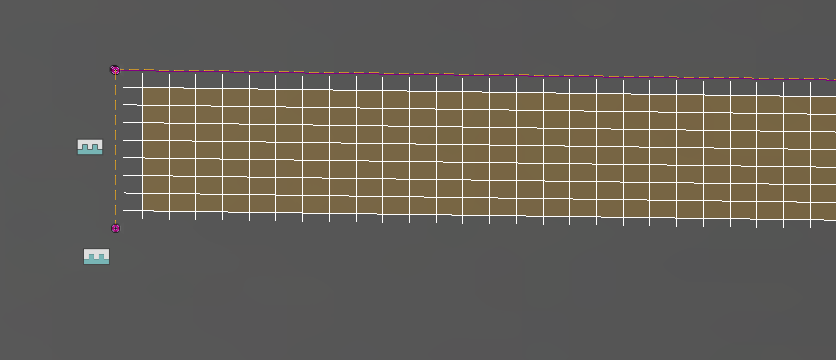

It seems that you have run into a performance problem in Fusion.  We think that this is most like the root cause of the problems that you are seeing.  We think that what you are seeing is just very slow compute, and if you waited a very long time, Fusion would eventually come back with the result.  We will get to work on fixing this problem.  The problem is in the pattern feature for the grill:
That pattern can take up to 15 minutes to compute.  Again, we realize that this is not acceptable, and will fix it.

One approach that I tried, is to use Web instead of Pattern.  I created this sketch (using Sketch pattern):
And then used Web to create the grill:
This approach takes the time to compute the grill down to less than 2 minutes.  Still slow, but probably acceptable.  This version is attached as "Vertical Sign.web.f3d"
