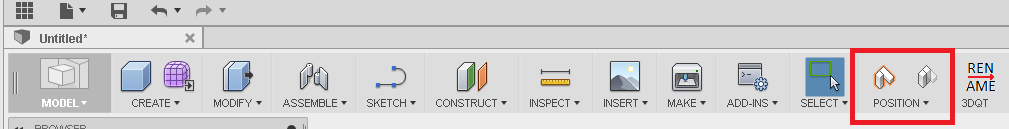

So if I do a Computer All on the design I'm having the big problem with, it runs, but 4 components get moved for some reason.  So, I moved them back using Align.  Then I tried to Compute All, and they move again?
Also, after the first Compute All, this component (a pulley) that is imported from another design gets majorly messed up.  This does not surprise me, as I know that component has issues.  I'd be happy to just delete it and redo it from scratch if that fixes things.
So the strange thing is that, that pulley comes from another design.  I knew it was messed up in that design.  But now, it does not show as having any issues in that design.  Clear as mud?
It just seems to me that something happened in the software, whereby, designs with components with issues, became scrambled up.

If you allowed me to download, then I could create a copy of my own to review. I'm also happy to speculate to the best of my ability. 🙂
Are you capturing Snapshots of the components after moving them with the align command? If not, then it may make sense that compute all dismisses the current snapshot and moves the components back to the original location.
Does that help?

Yes, that does make sense about the snapshots I guess.
I have made some progress. After the Compute All, I have been able to delete the pulley which I believe is the source of much of the problem. And now, I have been able to update the camera, and delete a couple other extraneous objects that I couldn't delete before without blowing up. I still have a few issues in the timeline, I'll try to clear them out. They are still related to the pulley, though they shouldn't be.
I'm not longer worried I'm going to lose the whole thing, which is good.
