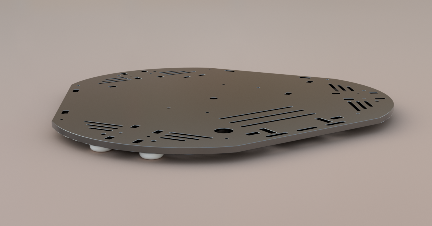

Ok this drives me nuts, why does the local renders look different then the cloud renders?
You can see the white dashed lines at the bottom corners...then the white highlights on the floor around the feet......
This needs to be fixed, it shouldn't make any difference other then time to render between local and cloud rendering.
It appears that the local render uses a polygon lower resolution mesh then the cloud uses..........You can actually see faceting at the rounded edges on the local render but not on the cloud render.......

chengyun.yang
Hi All,
Thanks for the feedbacks. About the tessellation quality issue, it can be worked around but we do understand it is not obvious to the user how to do that. What you need to do is to zoom in on the problematic part(s) of the model while in GPU rendering mode and then enable ray tracing. Zooming in means a finer LOD is chosen and once that has been used in ray tracing it will still be used even if you zoom out again to see the whole model. The key here is zooming in before you enable ray tracing because we don’t allow any tessellation update to happen while ray tracing is enabled since that would lead to “stalls” when rebuilding the internal acceleration structures for ray tracing. I will bring this issue to our product design team to see if we can do some improvement soon.
On the other hand, Fusion is going to release a new local rendering feature(Probably in March major release) where we will allow you to do the local rendering in the background, as a complementary/additional solution to the existing viewport and cloud rendering. When that is ready, there will be more options to control the rendering quality and performance. Please stay tuned.

PhilProcarioJr
@chengyun.yang
Thank you for explaining how to fix the tessellation issue. Much appreciated.
Honestly, that's a bad way to handle it, just give us a slider or a button please.
This is another piece of information that should be in the documentation because it will be lost on the forums in a week or so.

PhilProcarioJr
@chengyun.yang
Here I zoom as far in on the bottom plate, then turned on ray tracing and as you can see on the bottom left corner of the plate it still shows the tessellation issue. Have you guys gotten the chance to look into this issue? It's harder to see on this render but when I render it larger resolutions it very clear.

PhilProcarioJr
Here you can clearly see it, I zoomed all the way in on the plate then turned on ray tracing and zoomed out and let it render for 1000 iterations.
