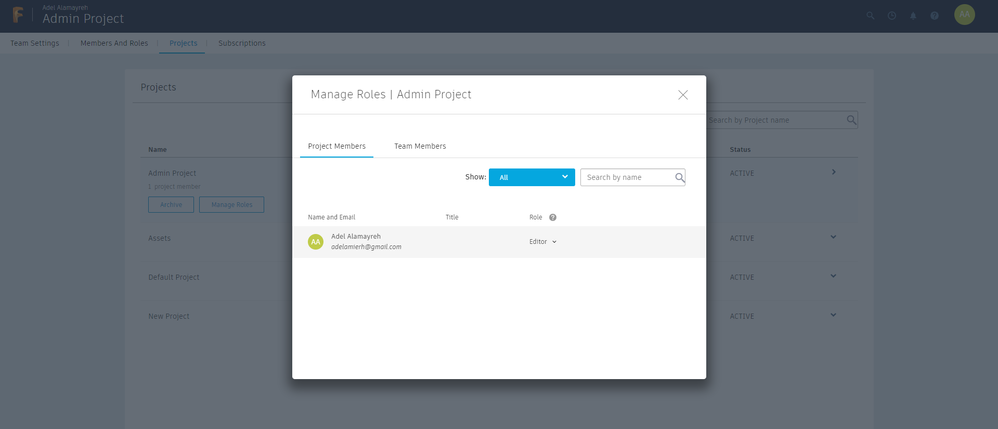

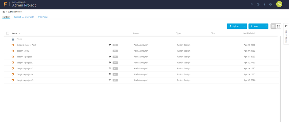

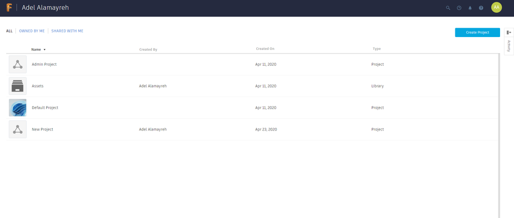

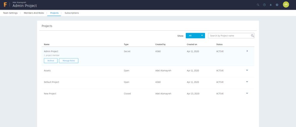

@James.Youmatz Here are some images of what i see when i login to that account
Also i would like to mention that when i change the role from Editor to Admin, it stays as Editor so I'm confused
This next image is what i see on my computer, the owner of this account having this problem can't see any of it except for the Trash option
Which makes @robert.filiks  idea more scene i guess
