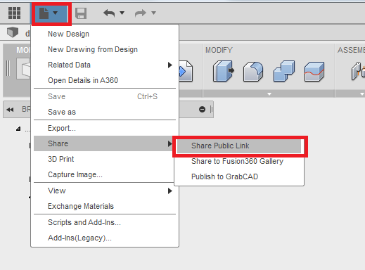

Let me know if this helps or if you have further questions. If at all possible, it may be helpful to share the design via a public link or to create a screencast of your issue.
You can download Autodesk Screencast from the below link.
https://screencast.autodesk.com/
