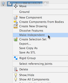

When you paste the component, use Paste new:
If you have already pasted, you can select the component in the browser and select Make Independent:
- Ron

You need to copy the component first, deselect it, then right click in the workspace to get the marking menu. You should see options to Pase or Paste New. If you had used Paste and therefore had a linked component, you  could RMB in the browser on the component and select Make Independent.

You’re right- the answer is incomplete. The “Make Independent” command is not available in the timeline environment, only in direct modeling.  But the “Paste New” option is available in the timeline, and he said he did not see that either. Paste New is how you get independent components in the timeline environment.
The second part of my reply, about removing the link between already pasted components, would only apply in the direct modeling environment.
In your case, you could roll back the timeline to before you pasted those components and use the paste new command. Then you would be able to edit each component independently.

The "Make Independent" option will only appear if you are in Direct Modeling mode, not capturing history. If you are using the timeline / in a design capturing history you would need to use "Paste New", as you have found. Command differences between the modes can be confusing, but there is also a lot of power in having both direct and parametric environments available.
