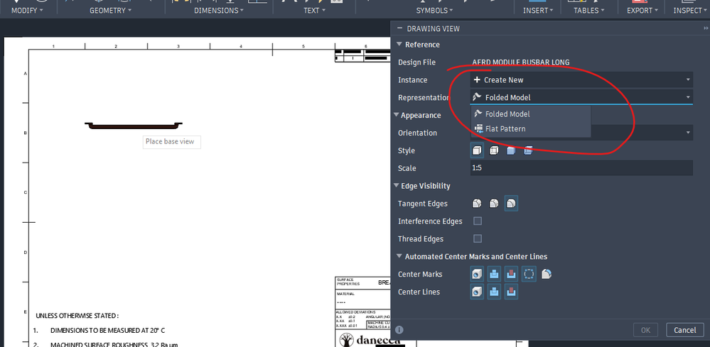

I have a problem. I want to create folded drawings using Automate Drawing. In the Flat Pattern section, there is an option to add a folded model isometric view to the drawing. When I check this box, it generates a flat pattern isometric view instead of the folded model. I’ve attached a screenshot of the checked option and the result it generates. Can you help me with this? What’s causing the problem?

I can reproduce the issue, and isometric view is added from flat pattern mode, which should be created from folded mode as option settings
It has been reproted to dev team for fixing. DID is FUS-257220.

For the parts I want to bend in Abkant, I need to create bend drawings for them, and I want each sheet to include a flat pattern and an isometric view of the part. In Automation Drawing, under the Flat Pattern section, I try to add an isometric view for the folded model, but it actually shows me the isometric view of the unfolded part, not the folded model. Look at the attached file.
Message 6 of 11
aleksei_ovsienko
Insert two base views. One based off of a flat pattern, another based off of the main part (folded). Like so -

Yeah, but if I have 20 components, what am I supposed to do? Sit there and make them all by hand? I’d waste a lot of time that way. With automated drawing, it does it all manually if you set it up to go from the Flat Pattern—Isometric View to the Folded Model. It makes the work a lot easier.

If you go to Automated Drawing and want to create multiple drawings at the same time, in the Flat Pattern section, you should check the option if you want it to generate an isometric view from the Folded model, since the software defaults to an isometric view from the Flat Pattern model, which doesn't help me. I want it to be an isometric view from the Component.
Message 10 of 11
samuellmagda
I want to create drawings like the ones in this model, and there’s a feature that’s supposed to let me use both the Flat Pattern and the Isometric View from the Folded Model, but, as I said, when I check that feature, it still shows the isometric view from the Flat Pattern. Can you update it so that it uses the isometric model from the Folded Model? Because with many bending drawings, it takes a long time to enter both views manually.
