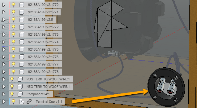

If you wish to insert a component into your design, and wish for this inserted component to be a reference of an external file, such that when you change the external file, all assemblies that reference it update, do the following:
1. Right click on a design in your data panel and pick Insert.
2. You get one chance to move it without creating the need to capture position when it appears in your new design. After that all moves are parametrically captured in history.
3. If you want to edit the linked design, either open it from your data panel, or right click on it in the assembly browser and pick Open.
4. When you are done editing the linked design, save it. All referencing assemblies will show out of date notifications and prompt you to update the assembly to see the changes.
Step 1
Resulting linked file:
