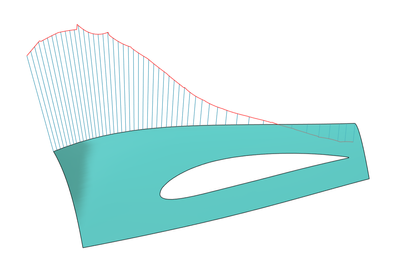

looking at the curvature comb, at first glance it doesn't look so bad (but not great either)-
however, if you look closely at the comb in the area that I cut out, we see the comb has some flat spots on the red line where I would expect it to be curved-
this is a resolution thing.  a limitation of the curvature comb tool.  it means at a smaller scale there problems with this edge, but the tool doesn't have enough resolution to really show it.  but there is enough of a problem here to cause any type of thicken to fail.
might can be fixed in the original fusion model if you have it.  dollars to donuts there is a modeling technique that could be improved to fix this.  first place to look will be the underlying sketches.

@RJMathiyazhagan wrote:...I used splines with curvature constraints to create the airfoil edges. However, when I tried to use shell or thicken commands, I got an error message....
look at this screen shot-
you see how there is a peak in the comb at the top, but the rest of the comb has no value?  and not note that the scale of the comb is at it's max?  again, the issue with this edge is falling outside the resolution limits of the comb tool, so it's not telling the full story.  basically the curvature at that point is for all intents and purposes approaching infinity.  fusion (and computers generally) don't do infinity.  I would hazard to guess that the curve at that point actually curls back on itself  at a very small scale.   check the sketch for the loft profile closest to this face.  your going to find something is up with it.
I would love to hear any tips or advice you have on how to model this type of fuselage skin more effectively, especially for the shell command....
sometimes getting a critique on what you've already done before restarting can be helpful.  you could post your model (export as a .f3d) to get better help.
