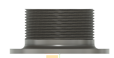

I am trying to model this part:
Thread terminates with locating rebateThread terminates with locating rebate
As you can see the thread stops short of the end of the cylinder and forms a nice lead in for the back nut to locate on. I've tried to create a similar model but can't figure out how to make the thread terminate nicely like that:
Thread runs to end of cylinderThread runs to end of cylinder
As you can see the thread just runs off the end of the cylinder wall. There is an option to offset the thread but that just steps it back from the end of the pipe, blocking any nut you would try to wind on.
Any of you Fusion gurus able to show me how to achieve this?

Hey @Anonymous ,
This technique will help you to achieve that - https://youtu.be/ngJPpCpg6zs. In this example, I used the Coil tool, but you can also use it with the Thread tool. Just remember to Untick the Full Length and manually drag it to the length that you need.

Here's another way using the built-in threads. The first part shows how to get a square end on the thread. The second part uses @Beyondforce's technique to create the lead in.

@Anonymous You can also just fillet the end of thread:

Thank you very much, etfrench.
This seemed to do the trick for me.
Sadly it took an hour or so, it's no fun getting old. The first answer linked to a video that seems very good, but was too quiet for my old ears even on max volume.
I could follow this video but had to put it on the big monitor and zoom in on the browser to make out the menu items.
But that's my problem not yours. Once again many thanks, I now have nice leader on the thread!
