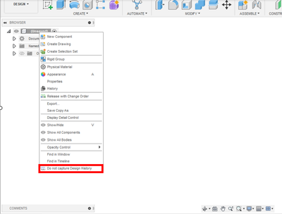

Im trying to use the Internal fluid volume command. Per the documentation Here:  https://help.autodesk.com/view/fusion360/ENU/?guid=GUID-99DD0AA5-F369-4814-A874-AD6605D58626
The fluid volume command should eb available in the design/solid/create. I can only find it in the simulation work space. Do i need to enable something separate?
Thanks in advance.
459 Views
sunil.patilQCZZK
Hi @jason.normanTTEKR ,
Turn of Capture design history and go to design/solid/create.
Right click on top level Model and Select Do not capture Design history.
