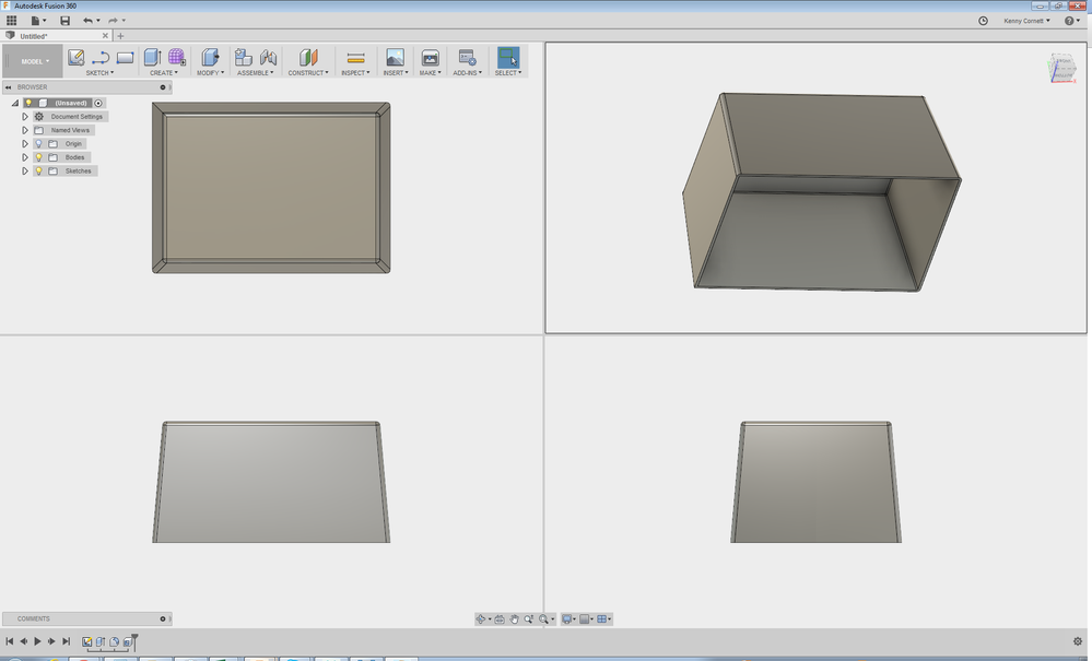

I still can't make out exactly what you have there, but hopefully this will give you an idea of how to apply it to your design.
I don't have Screencast on this machine, so step-by-step photos will have to suffice for now.
1. Here is my vacuum molded part.
2. Next I switch over to the PATCH workspace and then use a boundary patch to "cap off" the bottom of the volume.
3. Next, I switch back to MODEL and invoke the fluid volume command. Notice I stay on EXTERNAL to start with - this allows me to select both the solid and the surface at once. If I immediately switch to internal, I will have to pick individual faces (a pain).
4. I swap over to INTERNAL and there we go!
5. I changed the resulting solid material to a bamboo so that you can see it through the translucent form.
6. To round us out, I hid the patch surface and moved the resulting solid out for clarity.
K. Cornett
