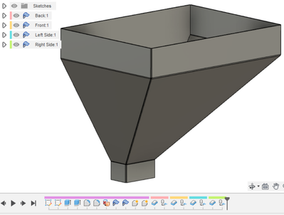

Hello all,
My company sells vibration feed scales. We make a lot of custom funnels to fit customers bags. I have attached an example of one the funnels I am trying to make. The funnels are always simple four sided funnels that we weld together after bending up the flats.
I am looking for a way to get each of the four sides as a flat pattern from a solid model. It is very quick and easy to draw the 3D models(2 extrudes and 1 loft) for these funnels so finding a way flatten out each side would be a great help.

There are too many options, but sounds like
2 Sheet Metal Components, make the Panel with addition of horizontal fillets,
Flat Pattern is one per component.
Might help....

I thought I already attached the file. Sorry about that.

That one would need 3 components, both sides are same only mirrored, cut two and bend accordingly.
To Flat Pattern you need the horizontal fillets,
make the funnel
split body for the 4 sides,
fillet the bends,
Sheet Metal component from body? May have to convert a normal component.
Flat Pattern.
Easier to draw it in 2d, 2 rectangles with 2 joining lines per panel.
Might help...
