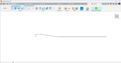

I converted a solid into a sheet metal, then when I unfold the sheet metal or created a flat pattern, some part of it is unfolded nicely but some part of it just turns into bananas 😭😭😭.It did not flatten it properly.

OK, problem found, there is an curve edge which is not tangent, probably a mistake when I am sketching.
TheCADWhisperer
Are there any unresolved issues highlighted in your Timeline?
Why not model this as sheet metal from the start?
