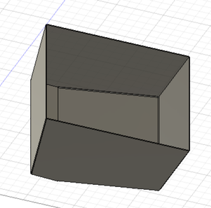

I'd like to connect the top and bottom flange to the front flange but I can't select the bottom edge of either like I did with the piece that is detatched. Please help

mattherrick95
This is what I'm looking for but with flanges

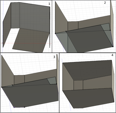

dominik_zarczynski
1) Create a flange from this edge.
2) Create a sketch on this flange using Project function in a sketch and extrude
3) Cut the unnecessary material with extrude.
4) Mirror what you did. To do that - first construct midplane.

johnsonshiue
Hi Folks,
Here is another solution using a different modeling technique. Basically, you may focus on creating the non-sheet metal body. Round the sharp edges with desirable radius. Then create a zero-offset surface (leave an opening). Lastly, thicken surface logically so that the part can be unfolded.
