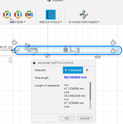

Been trying to figure out which toolset is the best for this. The length of the belt cut is 800mm (x6mm/wide x 6mm/tall) long. I have a 300x300 bed. Can't print a circle, strips with connectivity would have weakness, what about some sort of connected spiral/coil?
Tried my hand at just pathing it out with sketch lines then filleting and a sweep but getting the length to connect right is a real hassle; even then I'm not 100% sure my line is the length it should be with the arcs..
Anyone have a thought I'm missing on doing this easier?

maybe MST sketch tools  can help:

for an easy belt run, you could solve it like this. It would also have to be possible to implement it for a different arrangement.
Calculate distance for belt pulleysCalculate distance for belt pulleys

Draw a rectangle slightly smaller than your print bed. Fillet the edges with an arbitrary radius between 95mm and 100mm.  Calculate the length of the curves (2*PI*Radius). Subtract that from 958.55.  Divide that by 4.  Set the length of the straight lines to the result.
If you want to print different size belts, move all of the calculations into user parameters.  The above will work for any belt up to 1200mm (except that would have very square corners 😀 ).

i have the impression that you have not dealt with the process shown in the screenshot (#4/8), otherwise you could calculate the distance(s) in the parameter table with the real length and the involved arcs of the rolls.
The procedure can also be used with other arrangements such as those of @etfrench .

I actually used Excel to do the calculating.  MST Sketchtools was just used to show the results.  In any case, using parameters can eliminate the manual calculating.
