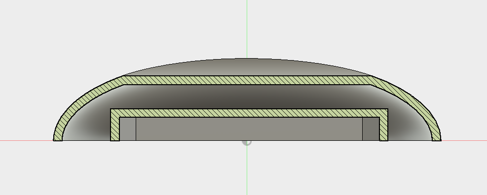

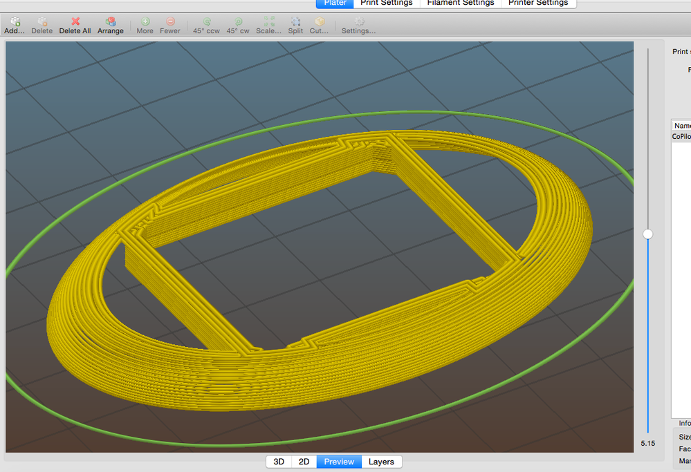

Here is the actual problem:  When the object is exported to an STL the square and the sphere are actually two separate pieces.
I am worried that there is a fundamental understanding around creating objects in F360 that I am missing.  If it will help to view the file as well I will try and figure out how to get it posted.

The reason it is 2 pieces is because the model inside fusion is also in two pieces. If you do a section analysis you can see they don't actually touch each other.
w47rlgI
In order to correct this, I would suggest just extruding the top face up further and using the Extent "All" to make the bodies combine. Like this:
WJGp1sh
Then it'll be one solid model! 🙂
Let me know if you'd like a screencast of it.

I've seen this in Slic3r when the shell is too thin.  Can you verify that it's actually 1mm thick using the Section Analysis tool on the Inspect menu?
ETFrench

Ah! I actually don't have any experience in Slic3r so that's good to know! In this case however, it was simply the fact that the extruded body was simply not enough to reach the other body. Not sure why I choose the section view I did since that was a poor representation, here's a better view:
wIjGl9s
Now you can clearly see why it was showing 2 parts instead of 1! After extruding the top up though, here's what the section looks like:
luDc3uO
Hope that clarifies things and thanks for the info! 🙂
