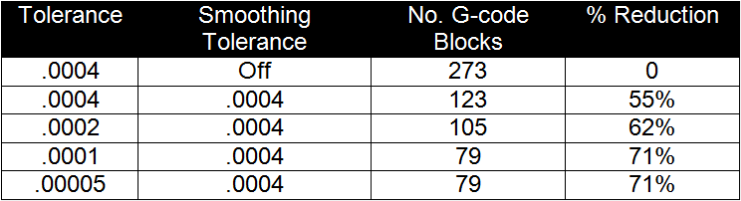

Some things to note about smoothing:
Smoothing works best when the Tolerance is equal or greater than the Smoothing tolerance.
The more accurate the data sent to the Smoothing "filter" the better job it does – up to a point.
A good rule is to set the cut Tolerance between 1 to 4 times greater than the Smoothing tolerance.
Here's a table showing how sometimes a tighter tolerance can actually be better than too loose of a tolerance. The video recommends setting the tolerance to 0.001" which is probably a good starting point for routers and large parts.

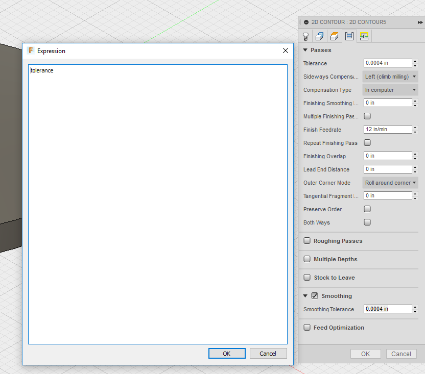

@xander.luciano @al.whatmough When I started using Fusion something I found odd about the smoothing tolerance is it defaults to 10x smaller than the op tolerance. I've used several CAM programs before Fusion and they all recommended the smoothing to be set similar to Xande's chart.
If you right click the smoothing input field and select Edit Expression the default is tolerance * 0.1, this seems a bit odd, is there a reason. I've change mine to tolerance * 1.5 and just adjust the op tolerance depending on the size of part and accuracy required.

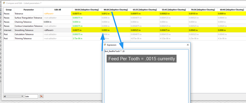

Well that is a very good question and just led me to discover a few interesting things about the default settings! So check this out, the expression for smoothing for 2D contour is just tolerance
QNV6YWw
So scratched my head for a little bit trying to figure out why ours were different when I realized that you were looking at adaptive. Ad adaptive is in fact 0.1 * tolerance
Which then led me to realize, that for 2D adaptive and pocketing, the tolerance is .004, while the tolerance for 2D contour is .0004 - 10 times smaller than adaptive or pocketing.
In order for these operations to all have the same default smoothing value, the expression for adaptive and pocketing needed to be reduced by 10. Which directly contradicts what the above information says about being 1 to 4 times greater. For 2D adaptive and pocketing, the tolerance is 10 times greater than the smoothing value.
Question now is, why is the adaptive and pocketing tolerance so loose? Quickly looking through a few other operations, the rest of them seem to be .0004" tolerance by default except for 2D and 3D adaptive and pocketing. This could be because they are considered roughing operations and having a tighter tolerance would cause longer toolpath generation times?

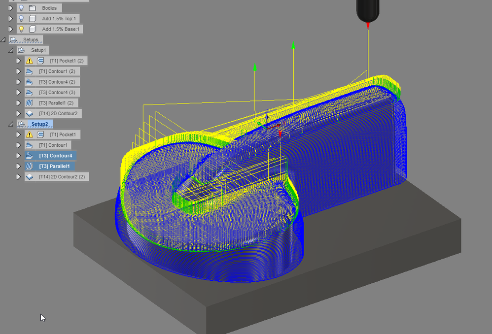

I did come across a problem the other day, I was using the waterjet op to produce a program for my wire eroder and found smoothing messed up the toolpath. 2D ops made from just lines and arcs will produce lines and arc and don't need smoothing, the exception would be adaptive. If any errors creep in with an adaptive cut it shouldn't matter as it's not a finishing op.
Here's the smoothing problem path, with smoothing off the path was perfect.

The reason for the loose tolerance is calculation time, it will be a lot faster set to 0.1 rather than 0.01 but one advantage of the longer calculation time is with a tolerance of 0.01 and smoothing of .015 you get a smaller program and because the toolpath's smoother you'll get better feed rates as well.
I see now it's only the pocketing op set to Tolerance * 0.1, not sure if more ops had the same in the past. It does look like the settings are aiming for 0.01mm in all the ops using the default op tolerance.

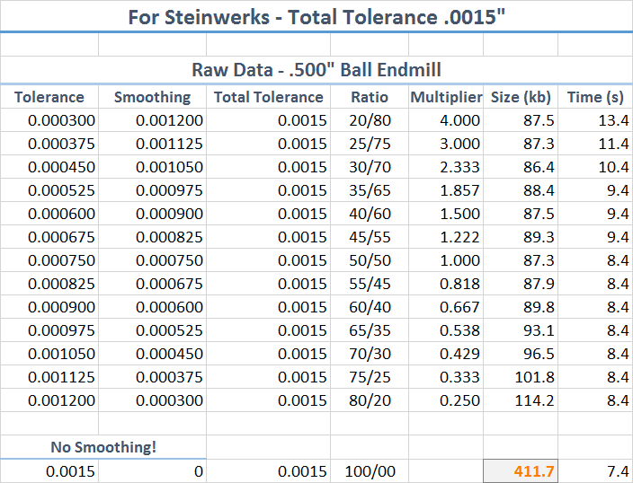

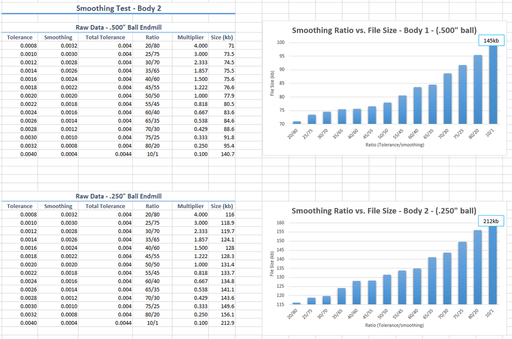

Hey guys! This has turned into a really interesting topic and discussion!
So just a quick data drop, I'll let you guys tell me what you think of it all.
This data set shows a comparison of tolerance to smoothing ratios. Everything from smoothing = 4 * tolerance to smoothing = 0.25 * tolerance
You can see a noticeable change below 50/50 with the .500" ball endmill (diminishing returns).
N8kcw0y
Here are a few of the toolpath generation times, practically identical:
ROfsUXn

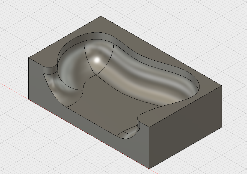

3D Adaptive with identical settings on this model - the extruded cut is made with a spline and then fillets added:
F95O9Ci
Let me know what your thoughts are on this data and if you'd like to see anything else!

I'd like to see the model!
Also I generally set Adaptive to .0005" tolerance and use a Smoothing value of .001" so I would be curious to see a dataset with a good tight tolerance instead of the loose .004" version.

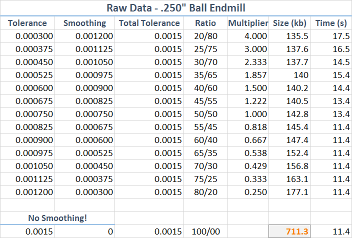

Hello all, I'm back with even more data!

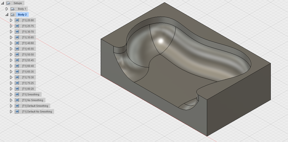

This time I recorded the generation time with the Task Manager inside Fusion so we could see how our changes affect the generation time. Now the Task Manager doesn't really respect the "manual start" or "1 consecutive task" options. So to be accurate, I generated each of the 13 operations 1 by 1, twice, so that each operation would have the same resources available to it. Overall, the results were consistent.
I also upgraded my excel graph making abilities to make the graphs look a little nicer, and added data labels to help compare everything a little better.
I also ran both these tests with the same exact part from the last post, so the file sizes between the last post and this one can be compared to each other.
Lastly, since I figured I might be doing more of these tests I created a CAM setup that uses the "Feed Per Tooth" value as the Total Tolerance for each operation. Each of the 13 operations uses expressions to instantly calculate new tolerance and smoothing values from the Total Tolerance value.
rr2Xsxd
Here is how I currently have the CAM setup for this:
yHC8JVr
Editing 17 operations was a long process before

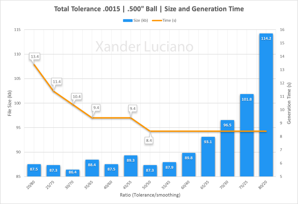

Ok enough of the boring stuff, let's get to the data!
0.0015" Total Tolerance | 0.500" Ball Endmill
The Results:
Ul1SKCw
Raw Data:
FkKUg71
Even with the tighter tolerance, we are still seeing a very clear decrease in file size - all the way until the 50/50 ratio! We also don't have any noticeable difference in toolpath generation time until then either! Compared to the toolpath without smoothing, there is very little noticeable difference.
Onto the next data set!

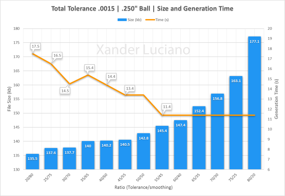

0.0015" Total Tolerance | 0.250" Ball Endmill
z3K8lvD
Is that not a perfect graph? With the .250" requiring more passes we starting seeing some really nice smoothed out data. Once again we see noticeable reductions in file size all the way to the 50/50 ratio, where we start getting diminishing returns, and increased toolpath generation time.
Again, we see a steady generation time up to the 50/50 ratio, where it then starts increasing.
Raw Data:
ye8fFqe
Let's just look at the size of that file without smoothing. Yep. 711.3kb, that is 4 times the size of the 80/20 toolpath! We're seeing a massive increase between not using smoothing and using smoothing.
