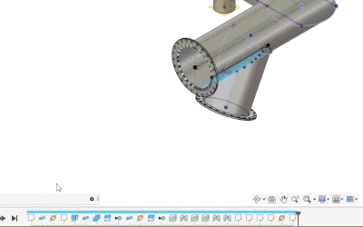

g-andresen
here is another way to see the relationship.
günther
