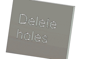

I am working on an stl found on thingiverse. It basically is a phone case. It has a text on it, which is like a hole in the case. I'd like to remove it. So, patched the surface and extruded that. Now I have a surface and a solid. Besides the fact that I have not understood how to make the surface a solid, I'd like to merge those two in order to fill the hole. Here is the screenshot of my situation:
As you can see, I have two surfaces (the whole case and the patch) and the extrusion.
Also, here is the link to my project: https://a360.co/36VTPpw
Thank you very much in advance.

g-andresen
1. if you create a public link, do not forget to allow the download.
2. otherwise take this way:
File > export > save as f3d on local drive  > attach it to the next post.

TheCADWhisperer
Window Select.
Mash the Delete key.

try this

placidopellegriti
I am very sorry. Please, try again now.
Message 6 of 8
placidopellegriti
Please, try this new link: https://a360.co/3i6aIVb
Message 7 of 8
placidopellegriti
Sadly, only the inside of the letters gets deleted. Thank you a lot for your answers, please take a look at the new link I uploaded
Message 8 of 8
g-andresen
watch the screencast and follow the timeline
