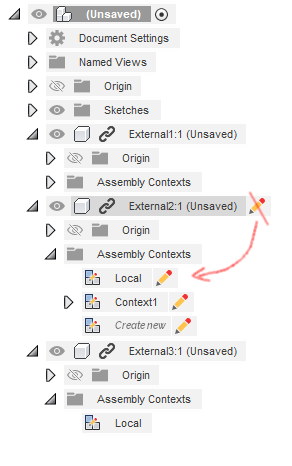

One has to be aware that "edit in place" is very different from "activate", in that it creates features in the top assy with a defined place in its timeline. And if you edit-in-place a component multiple times, that it might automatically create extra context features. This was not at all clear to me beforehand.
Maybe it would be beneficial to explicitly force the user to choose a context on edit-in-place?
E.g. by presenting a dropdown menu:
or by moving the edit-in-place pencil to the assy contexts:
Re. the warning message: I had no clue what it meant.
For a start, it gives you the options "Edit Context1" and "Create a new context if you make associative edits". But  if you're editing Context1, you are also making associative edits...

What does it mean when there is no referenced geometry under the context in the browser? It means that an edit was done in the child model that uses component positions imposed by the current parent assembly but no geometry from the parent.
I had indeed edited-in-place a component to add a subcomponent, and since I had pressed the pencil instead of choosing the existing context, it had automatically created a new context (which remains empty as no reference geometry was selected, only a component added).
Anyway, all this is resolved as long as I refrain from clicking the pencil icon, and activate a specific design context instead.
Thank you!
Excellent suggestion! I'd prefer this one.
