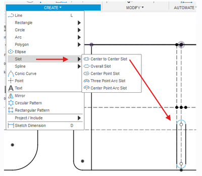

In addition to other issues - you are creating your Slots in a computationally expensive manner... ...there is a tool for this.

Hi CADWhisperer, thanks for replying. That is not supposed to be a slot. That is the outline of a pedestal that will extrude into life once the sketch is completed. This is supposed to be a simple plastic bracket that I will hang my Oculus from and the holes are for the controllers. I have no idea how many itterations I will go through before I get what I want, but this is the start. As such, the beginning must be perfect.  I read Drewpan's comment also. I am not offended be called a beginner. I am!  He said; " Simple sketches are the easiest to constrain correctly and fully constrained sketches keep fusion from 'guessing' what you actually want and lead to far fewer errors later on." Here I thought this was a simple sketch! I did fix the part of the sketch that I originally posted about by adding a dimension that set the distance of the 'non-slot' from the edge. But there is still some unconstrained thing that I cannot identify. I read that I could enter a command in the Text Command window that would highlight the unconstrained items, but I can't find a way to open a text command window.
