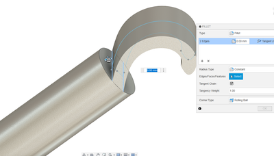

I wish to create a fillet between the hook and the rod on both sides to strengthen the mount but when I try to use the fillet tool it points inwards rather that outwards. I have tried to combine them first but still the same. What would be the correct way to achieve this please?
(I have attached the file)...

Combining fails due to lack of contact between hook and rod.
Project the profile of the rod onto the sketch and connect the projection with the hook profile.

Here is another approach:
g-andresen
one more
günther
TrippyLighting
And another version with an even more pleasing transition:
