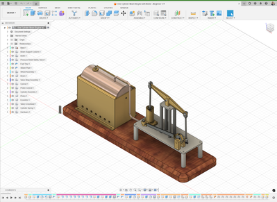

Screenshot 2025-06-18 at 9.50.14 AM.pngI'm working on an Add-In that allows the user to set component colors recursively for entire component hierarchies, partial hierarchies, or for individual components. The user can choose to automatically shift the hue of the descendant's component color based on an offset and it's depth in the hierarchy, and also automatically shift the luminance up or down  similarly.  The idea is to very quickly allow the user to differentiate components throughout the hierarchy whilst descendants have traits identifying their parents.
It's pretty much working but needs a little tidying in areas.

1. In the production world do engineers and designers actually use component color.
The short answer is Yes. The longer answer is what for and why. It seems in your plug in that you are using colour to show
Assemblies as collections of coloured Components to help group them together. This makes sense to me and I could see it
being quite useful. That being said, it would work quite well with designs that use the same material, say everything is steel.
If I was using multiple materials then it may confuse the issue because while designing many designers will model with the
material if it is available. The reasons for this can be complex and software specific but in the case of fusion I can model
this way and get the software to accurately calculate COG and such things. I suppose really that a Designer is more likely to
care about modelling more accurately with the actual materials. An Engineer is maybe more concerned with how it all fits
together. Different departments have different needs. The Assembler just wants a diagram about how it all fits together and
so Assemblies grouped by colour is very useful. Marketing wants an amazing graphic to put into the marketing material and
so lean more towards full colour by material. It is a tricky question about who exactly would use the functionality you are
creating and why but, I think it would be useful to some.

niikpalmer
Thanks so much for the feedback. I fully understand the physical material  being used as the "color" differentiator. Your feedback makes sense and I'll work it into my next iteration, thanks for your time and effort.
