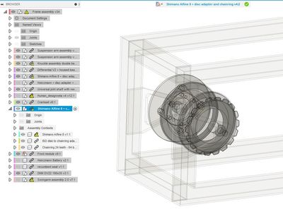

4. the wired view of the Edit In Place is also a bit disrupting, I mean in Catia when working on a sub part we have the assembly around still in a "solid" view and that is pretty good if you need to take some measurements on other parts
Also on some parts, when I use EIP, the part or assembly that I want to edit is also in wired view (while in non associative context). It can come back to a normal view when switching to an associative context but I prefer to leave that off in order to avoid any mis linked reference. Or when switching to a local context but then you loose the possibility to take some measurements.
wired view during in context.JPGwired view during in context if assembly context activated.JPGnon wired view during in local context.JPG
