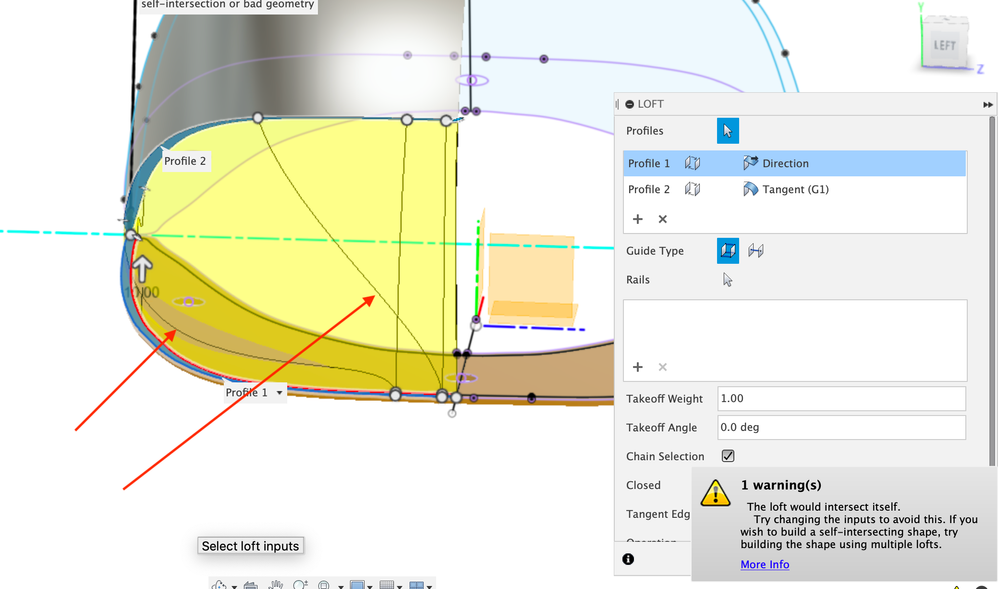

I have been struggling with a loft I want to create. Been searching and googling but have not yet found any solution.
I want to connect to profile on the bottom part to the edge of the top part, so the shape flows nicely. Sometimes the loft will not succeed (is this because of the touching points at the right?) and sometimes the loft will succeed, but I get all kinds of weird shapes and bodies that don't even connect with each other.
What am I missing here, what can I do to make this part? Have also tried sweeping and the splitting bodies and faces, just to match things up, but not with the result I want.

This is, at the root, a problem with "point mapping".  When the profiles in Loft have a different number of points, Fusion has to try to figure out which points map to which in each profile.  Even modeling just half here (which is, indeed, a good strategy) still has mapping problems.  Sometimes, you can untangle the mapping by dragging on the white point handles, which is tedious at best.  I played a bit here, and was unable to make it work.  The usual approach in these cases is to add rail curves.  Rails help constrain this point mapping problem, and guide the algorithm.  Even that is a little complex, since you then have to put conditions such as tangency, etc on the rails.  But, one could probably make a decent result using just one or two rails (I did not try).
And yes, the fact that the profiles meet at the corner could produce a pretty bad surface near that corner.
Personally, for something like a motorcycle seat, I would be very tempted to do this as a Form (T-Spline) feature.  T-Splines are very good at this kind of "soft" modeling.  Again, use symmetry so you only have to worry about half of the seat.
