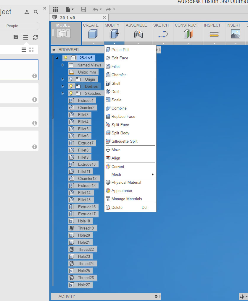

Inventor has the option to fillet by selectinig faces.  I can't see this option in fusion. Am I missing something?
Some you tube videos talk about 'Rule Fillet'.  But this option is not available in my modify menu.  Has it been removed?
Thanks.

Thank you for the reply.
I noticed it comes back when I start a new model, but on a model i built in inventor and imported in, the function is not there.
Message 5 of 15
josef.kucera
Cad files imported via Upload dialog which comes from other than Fusion360 (for instance Inventor) are not imported as parametrical designs thus you can not see Rule Fillet feature in your toolbar
But switching in to parametric modeling (please follow attached screenshot) Rule Fillet will be accessible again.
Regards,
Josef
