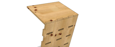

Heres a screengrab that shows what happens. I see no way to extrude a new component from the existing component without taking multiple steps that inevitably end up cutting off the joinery on the top of my component.

Your first sketch needs to be modified and then it is simply done with two extrusions.

It looked like you accomplished what Im trying to do, but I have no idea how you got there. If I hide the existing component it still joins or deletes part of it when I extrude.

Are you on a Mac or PC? I followed your steps exactly on my PC and your method didnt work unless I hid the original component before did the second extrusion. If I tried it your way with it visible it joined into the side piece and deleted all my joinery again.

I am using a Windows computer.  I made another Screencast because in my last one I did not make a component, I made a body.  Creating a new component is what you want and the process goes a bit different.  Please pay close attention to the "activating" of the newly created component before I do the second extrusion as a Join.
