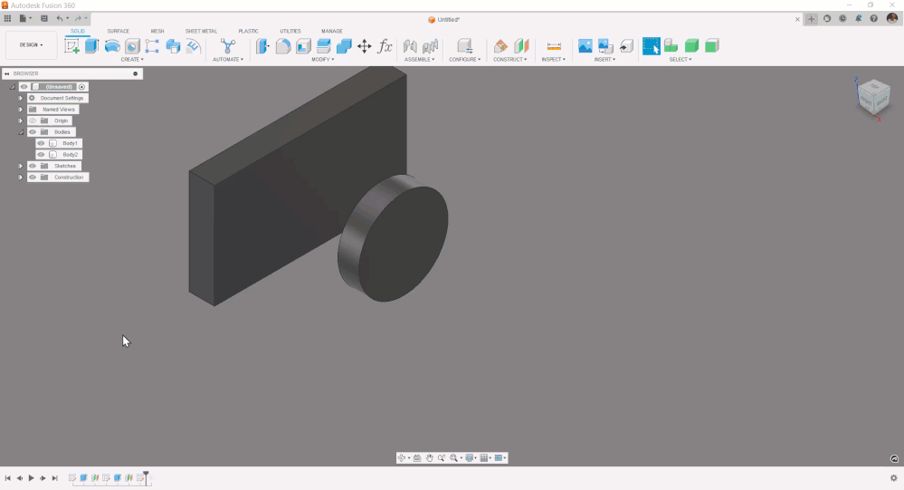

jhackney1972
Give the Emboss command a try.  It will join your sketch to a body behind any number of separate bodies between it and your sketch.  Animated GIF attached.
John Hackney, Retired
Message 22 of 27
crawlinbrain
Thanks for posting this workaround!
Just played with it a bit and wanted to list out a few limitations in case anyone is looking to try this out.
-New addition must be fully enclosed by selected face or it will be clipped
-New addition will only combine with the selected face. Additional bodies with need an additional combine feature
-No draft feature
-No thin feature
-No ability to offset from the selected surface
-No ability to extrude in multiple directions
