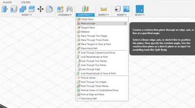

I ran into this issue today when I had to put in screw holes at a 20 degree angle into a part. There is probably a much quicker and easier way to do this. The method I used involved creating a Plane at an angle, drawing my Sketch on that Plane, then doing a Extrude Cut to get the shape at the angle I wanted.
It worked out ok.
