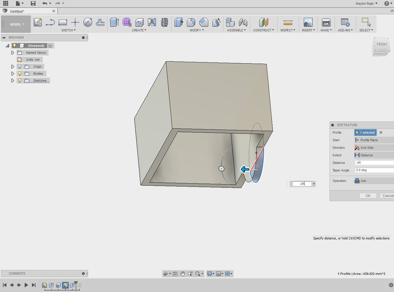

I shall place another interesting quark here as well, and that is When mirroring a geometry that uses a extrude to object command. Rather than actually getting a mirror feature, the feature created by the mirror, extrudes to the original object and not its mirror object.
Actually I went ahead and made it. See the images.
Couldn't add more than 3 images at a time... so the rest will be uploaded in a response to this post
mirror issue 1: A shelled out box, with a sketch on an outer surface.
mirror issue 2: Extrude the part of the circle I would like to add.... extend "to object", select the inner surface.
mirror issue 3: extrude (join) completed.
mirror issue 4: Mirror feature (the circle) about the centre plain. As can be seen in the image.
mirror issue 5: Definitely not what you expect right?!?!
Work around, while still being able to lets say modify the shell thickness and have it follow the change, cause if you give it a value it won't update with the shell thickness.
1. Open the change parameters menu after the shell action, and taken note of which value was set for the shell thickness. Use this value in the extrude distance section... in this case it was d5.
2. time line forward past the mirror.
See  mirror issue work around 1 and mirror issue work around 2 respectively.
Lastly... During this work around I found out that the change parameter window does not stay open. Starting an action automatically closes it. This is a bit inconvenient because if you want to make the whole thing driven and require to look up a lot of parameters you might still have to resort to pen and paper to keep track, or have to open the menu several times.
