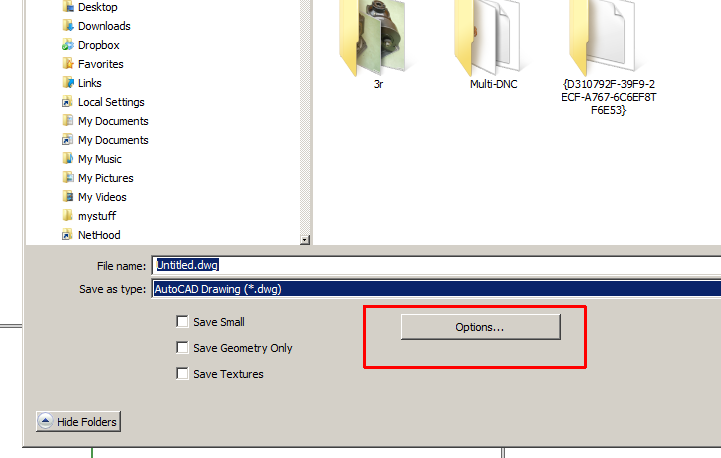

Message 5 of 13
Thanks Mark,
Where can I setup this options on Fusion 360? (I am using Fusion on Mac)
Message 6 of 13
HughesTooling
The settings I'v shown above are for Rhino, when you pick DWG or DXF the save dialog has a button Options.
Clicking the Options button brings up this dialog, I've shown both tabs.
Mark
Edit the standard Rhino schemes don't export splines to fusion correctly the setting above keep spline data as splines.
Mark Hughes
Owner, Hughes Tooling

HughesTooling
If you make an export scheme for DWG\DXF using the setting in my post above then you can get most information into Fusion, Surfaces, Meshes and Curves. If all you have is 2d sketches use DXF then use inset DXF in Fusion from the insert menu. If there's a lot of info in the sketches then I'd recommend using layers to split things up in Rhino then use One sketch per layer when importing into Fusion. One more thing to note, dimension and annotations are ignored only curve info is read.
Mark
