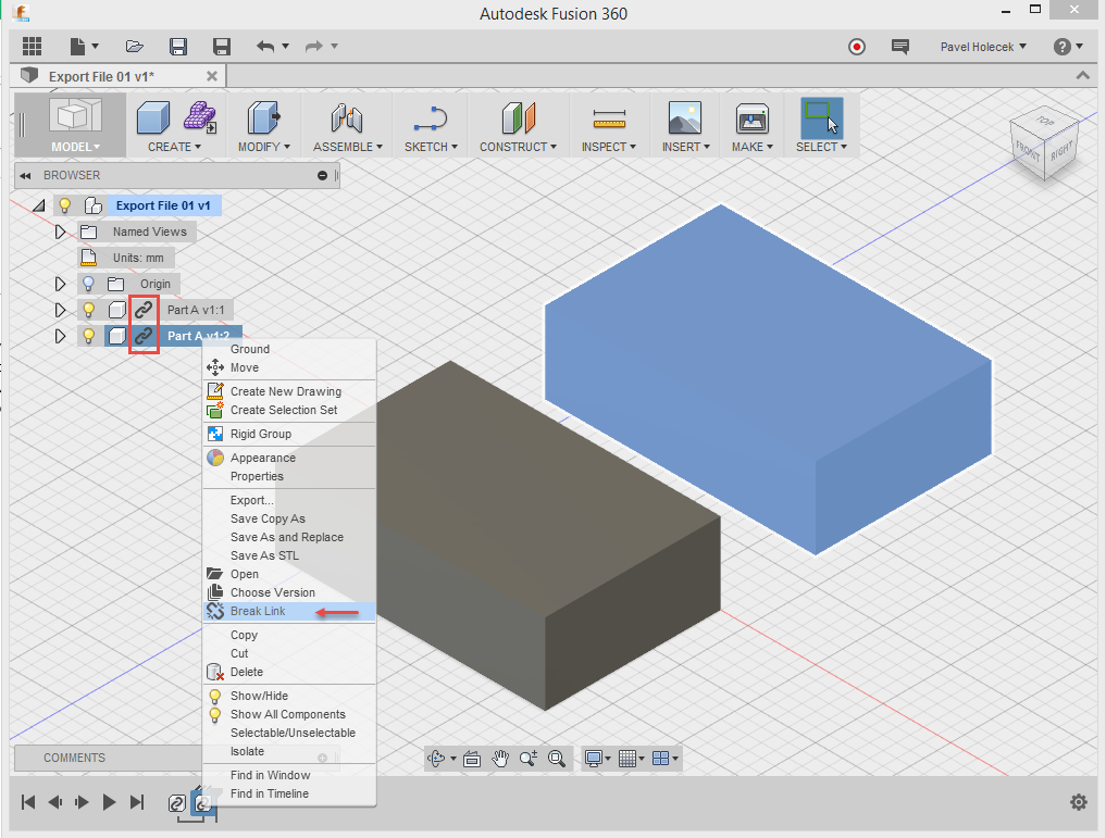

There is a small limitation in Export command - You have to Break Link for all components first. Then it will be possible to Export a design to F3D fromat.
Regards
Pavel

Oh, I was worried I'd have to start everything from scratch. Thank you!
