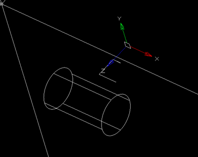

I exported the attached file as a DXF.  Instead of the flat pattern being exported, the model is exported.  It worked earlier with another version of the same file, but after some dimensional changes, it doesn't work.  I have saved files and restarted with no positive results.  Any ideas? Thanks,

I am glad it worked for you.  I just tried again and get the model.  It seems that everything worked just fine prior to the update today.  May be a coincidence, but I cant seem to get a good file of the flat pattern.  When I export, I get the attached

Message 9 of 13
MRWakefield
If I open your DXF in nanoCAD I get this:
If I open @jhackney1972 's file I get this:
If I attempt to open yours in Affinity Designer I get the following error:
Clearly some 3D solid geometry in there!
Are you sure you're exporting as the other contributors have? If I export the flat pattern I get the same result as @jhackney1972

Not sure that this makes any sense, but here is where I am.  To export a dxf, since I have used Fusion, I have always clicked on file, export, selected dxf as the file type, selected the destination folder and it would take a minute or two because it says it goes through the cloud.
I just tried the same file and clicked on the DXF Export tab to the left of "Finish FLat Pattern" as you indicated.  It gave no option that I saw for the file destination, but when I looked in the same folder as previous, it was there immediately.  I went to Sheetcam and imported as usual and now it worked.  Can you/anyone explain the difference between the two scenarios for creating a dxf in Fusion?  Clearly the outcome is different.
Thanks for the help.
Steve
Message 11 of 13
HughesTooling
When you use Export from the file menu you will get an export of the 3d model. The only way I can think you got a flat pattern this way is if you used unfold not flat pattern and saved the file in the unfolded state.
When you export from within the flat pattern workspace when you export you get just 2d entities, the outline and the bend lines.

As far as I'm aware, choosing export from the file menu has always exported the 3D model. However I'm not very familiar with exporting flat patterns so I can't say whether anything has changed in this regard or not. Perhaps someone that has more experience with exporting flat patterns might be able to give more insight. Anyway, I'm glad you now have a working method of getting your flat pattern geometry over to SheetCAM.
Here's the workflow I went through:
To save locally the "Save to my computer" must be checked (which I'm guessing it was already been since you didn't mention it). You can choose where it gets saved by clicking the ellipsis button (circled in green in the screenshot).
