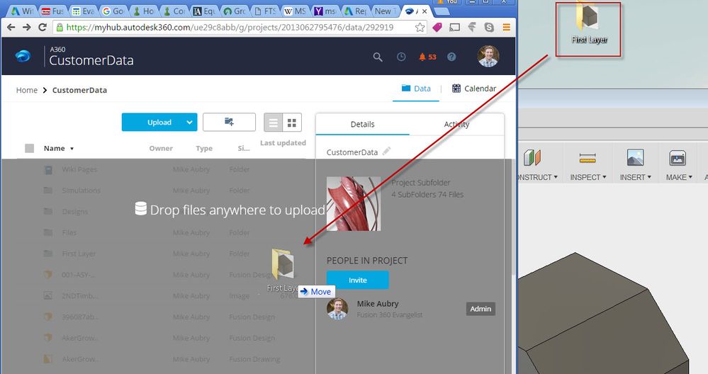

    • There is a way to import while maintaining the file hierachy.  Drag-and-drop the folder from within A360 (the browser based part of Fusion) instead of the data panel within the Fusion360 Modeling App:
    • Then just drag and drop in the folder. Folder heirarchy will be maintained:
    • This isn't a silver bullet. A360 uploads do not automatically convert .f3d files back to a Fusion item - which is needed to reopen within Fusion. What this means is you'll be able to view in our viewer but you won't be able to reopen in Fusion. The workaround is to right click on the file within the Fusion data panel and create a Fusion Design:
      • createfusionfile.jpg.
    • Then just delete the original. (We agree this is far from ideal. It's in our backlog. It does get you your file struture though)

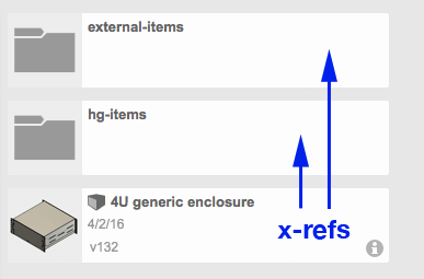

On the first bullet - importing while preserving file structure - I think we might be talking about slightly different scenarios? In my case, I've exported a single .f3z file, which contains x-refs to designs in folders on A360. There isn't actually a folder to upload on my local drive.
For example, I might export the 4U generic enclosure below. This contains references to many items in folders, but on import everything gets dumped into a single place.

Hi Devon,
My bad, that is different. Thanks for the clarification. Exports for the .F3z files do simplify to a single path. Unfortuantely,  there isn't a way to change that right now.  I think the best way to go for now is to minimze your dependancies on xrefs.
