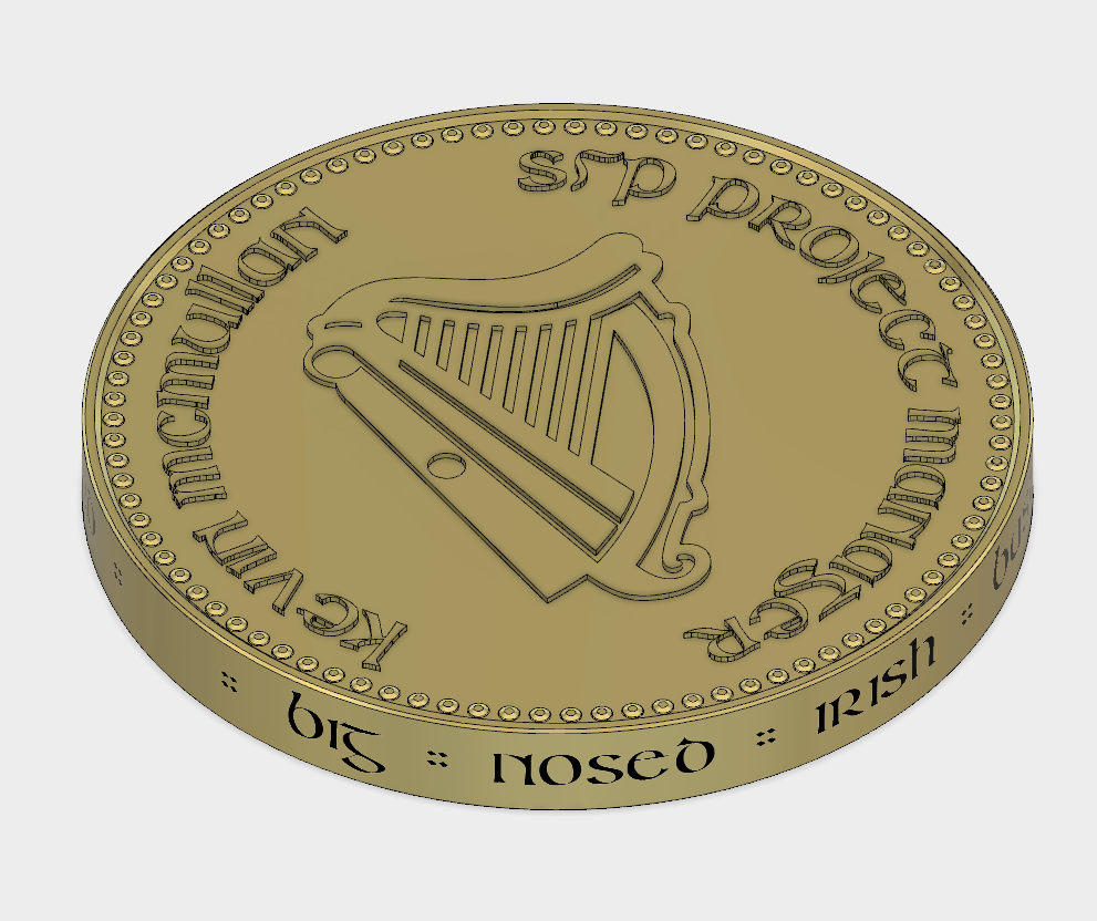

Hi Saeed,
thanks for the offer. Here is a screenshot showing the item so far. The Irish harp is also a dxf import as is the motif on the other side.
The text I want to add is shown in black around the edge. Here it's only a decal though. Having imported the sketch I then need to extrude it, cutting into the material.
A final step, though not really necessary, would be to add milling (ie corrugations) to this cylindrical surface).
Richard

SaeedHamza
Here is a quick screencast on how to do it
I hope it helps

RichardGerSpatial
Thanks Saeed, that did it. Sorry for the delayed response.
I hadn't explored the sheet metal tools, so now I think I will 😉
