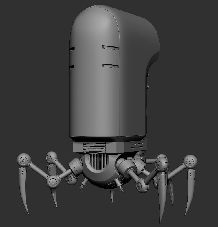

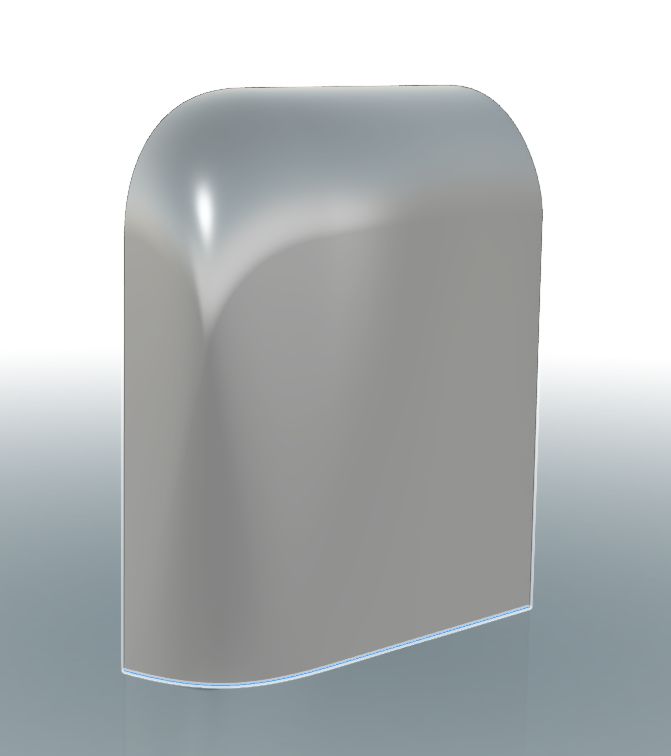

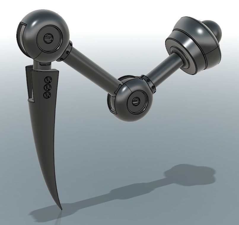

I was hoping you would be able to take a look at these screenshots (with annotations) of what I am trying to do and point me in the right direction.I am trying to remake a model I made using the 3dsmax booleans + zbrushI am trying to remake a model I made using the 3dsmax booleans + zbrushI was able to make the leg completely inside fusion 360 using the sketch workflow with use of loft and revolveI was able to make the leg completely inside fusion 360 using the sketch workflow with use of loft and revolveHowever I have no idea how to start creating something more complex like the body of this robot shown in the screenshotHowever I have no idea how to start creating something more complex like the body of this robot shown in the screenshot
I have tried extruding from the outlines of this shape and using them as booleans to cut the shape but that did not work as I hopedI have tried extruding from the outlines of this shape and using them as booleans to cut the shape but that did not work as I hopedthis was the resultthis was the result
If you would have any pointers as to where I should start looking I would be very grateful.

Easy! Either in solid modeling Patch or Sculpt mode is this easy to do.
Can you export the design (.f3d) you have so far of that one object or the whole thing and attach it to your next post ?
I am a little  confused about your reaction to the vertex pull behavior that you describe in your Verzückung first post. Any Sub-D mesh model behaves that way, whether designed in Maya or 3DsMax or Blendder, Modo,C4d etc. this is intriniśc to the Sub-D method.
