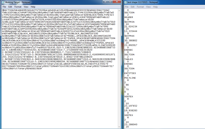

not sure if this is relevent to the issues you have been hearing about, but i exported my first dxf from 360 to import it into my Torchmate CAD software to do some nesting before cutting out the part and it crashes the torchmate software. It just hangs and i have to force quit it. I opened the dxf in notepad and compared it to one that works and the format is different.
Here is a screen shot comparing the one that doesn't work (left) to the one that does (right and from another program)
http://img.photobucket.com/albums/v727/shmude/CNC/dxf%20difference_zps1htpc7rj.png

I just exported a DXF and opened in Rhino OK, then opened in notepad and it looks like one on the right in your picture. Can you try another sketch, something simple. To make the export you are just right clicking on a sketch and selecting Export.

yep, thats how i exported it.  This is coming from the OSX version if that matters.  I'll try it again with something simple and see what happens.

OSX might be the problem, it uses a different format for the end of line characters. I think mac just use LF but a PC uses CR+LF, looking at your picture it looks like the carriage returns are missing.

no luck.  I was able to open the dxf on my mac with txtwranger and then save it as a windows txt file and that fixed the formatting issue but it still freezes the program when I try to import it.  It will import into the Torchmate driver software and generate G code off of it so its something with how the Torchmate CAD software is reading it.

Okay, i was able to do some more testing. I can take the exported dxf and import it into google sketchup and then export it from there and it opens just fine with Torchmate. So its something coming out of fusion thats causing it. I can send the files if you need me to.

I think I read somewhere that the DXF version Fusion uses is quite new and some programs can't read them. So depending on your point of view it could be Torchmate need to update there software.
