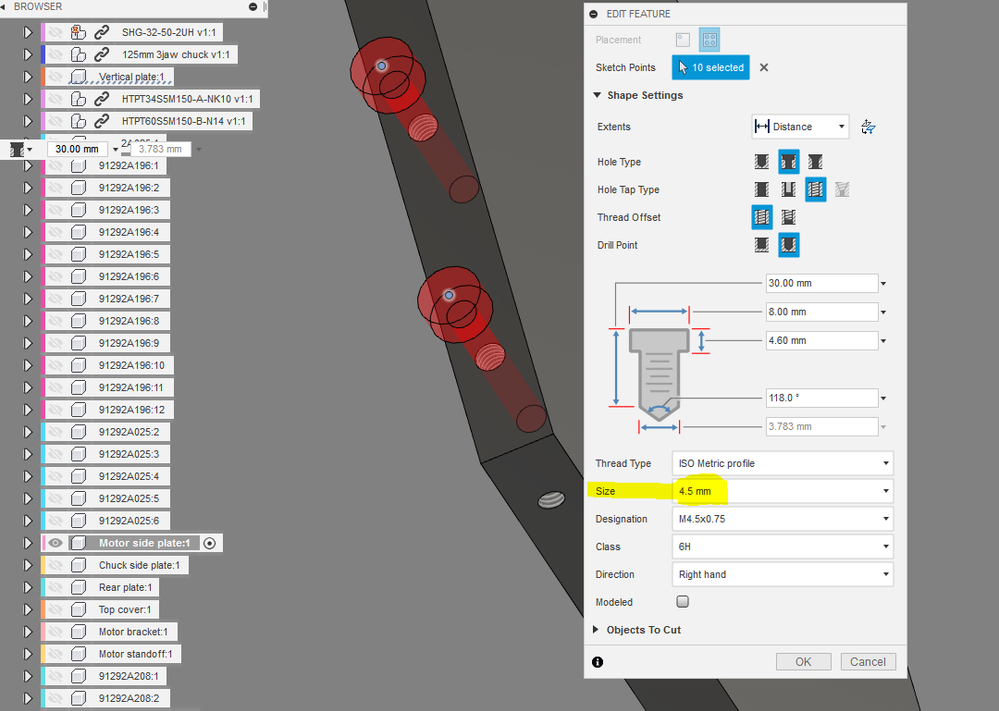

I created a set of compt drawings from my assembly for checking just now. Having spotted a couple of minor errors, I corrected them in the design space. Back in the drawing environment, I can't get the changes to come through. The design is now at v79 but the drawings are stuck at v76. How can I get the drawings to reflect the latest changes? I've attached a screenshot showing the different versions coexisting.
I've made sure the design changes are saved before going back to the drawings. I've even closed Fusion down and reopened both the design and the drawings. Still no cigar.
This happened a few days ago and so this is a recreation of those original drawings, as I assumed I was being dumb somehow.
Hopefully this is something simple I've not done! Can anyone point out what I'm doing wrong here?

@Muzzerboy
I was curious and changed your threads from 4,5 mm (your value) to 3.5 (resulting diameter in model: 2.93) and the other thread from 4.0 mm (your value) to 3.0 (resulting diameter in model: 2.53).
Then I saved the model, updated the drawing and the results are ok, no problems (see screen shots).
You have to be patient with the drawing update and wait until the cloud storage of the model is complete.

@Muzzerboy wrote:
I'm wondering where you got these odd hole dimensions from (4.5mm??). The hole dialog shows the M4 definition and when I measure the result, it's what I'd expect. Meanwhile, the drawing stays the same (3.78mm) no matter what I do.
To answer your question, this is what I did:
1) downloaded the drawing you published - the file: 4th axis assembly Drawing June.f3z contains the referenced model, that was all I needed
2) uploaded 4th axis assembly Drawing June.f3z into my Fusion 360
3) opened the model
4) selected the thread hole in the component Motor side plate , then mouse right-click to edit feature (see screenshot)
5) then I got the dialog-box with the 4.5 mm (see screenshot)
6) measured the hole diameter => 3.783 ((see screenshot)
I guess you dont´t work in the model that is referenced by the drawing - please see my post #9. The model referenced by the drawing is shown in the data-panel (see last screenshot). Please see what´s shown on your computer.

You have saved v76 of the 3D model as a milestone.
The drawing references this milestone and will not update until you save a new milestone. That is seen in your "Uses" image. The drawing uses v76, the milestone version.
Milestones are the way to add release management (in rudimentary form) to your designs. It also prevents version churn in production.
