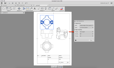

I am having a problem with the detail shown in my drawings.
The problem has appeared before, but it has not been critical.
Now however, there is detail missing that I need.
I have attached a PDF document showing the problem.
The front view is at the bottom of the sheet.
The top view is above that
The isometric view is to the right.
The front and isometric views show t-shaped structures that should be visible in the top view, but are not.
Why.
Regards,
Brett

Message 4 of 11
Further to the above.
I have included a slighly different drawing and the design the drawing was based on.
From bottom to top on the left side of the drawing the views are as follows
Bottom view
Front view
Top view
The isometric view is on the right hand side.
There are details and lines missing from both the front and top views.
I have ISO with third angle projection set in preferences.
I have a deadline for this component, can anyone help?
Regards,
Brett
Message 5 of 11
andrew.de.leon
Hi Brent,
Ok, thats makes more sense now. Sorry for not seeing this earlier. Since the t-shaped details are filleted on all edges, you may need to turn tangent edges on to see the geometry. To do this, double-click the view and within the VIEW PROPERTIES dialog change Tangent Edges from Off to Full Length. The geometry should immediately appear.

Message 9 of 11
Hi Andrew,
Thank you, that did it.
