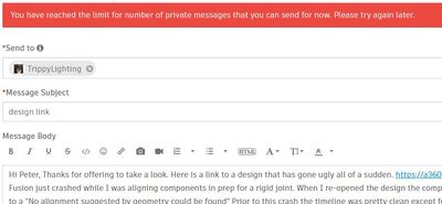

HenryDara
Hi Peter, Thanks for the offer. I typed up a real nice PM with a link to the design, but the Autodesk site unfortunately says I have reached my PM limit and to try again later, so I guess I will try again later. Didnt know there was a PM limit.
