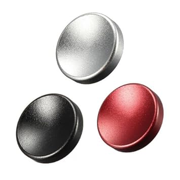

Hi, I wonder if there's a "dome feature" similar to solidworks in Fusion 360?
Alternative, how would you suggest me to "carve out" the concave surface out of a cylinder-like body? Let's say that cilinder is created carving it out of the surface of a sphere. So the surface I'm trying to turn into concave is actually not flat. how would you do that?
Revolving doesn't really work because it's not a flat surface.

I am not sure that I fully understand what you are asking but both the dome and the concace body shown by the three pucks can be achieved by using revolve. You just need to create a sketch of 1/2 of the body cross section through the center point. Then revolve that profile about the center axis.
